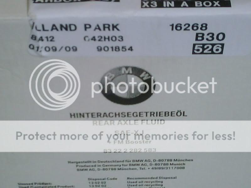

Keda see diffri õli vahetus huvitab, siis siin ka pikk jutt koos erinevate kommentaaridega, kus SAF ehk praegune Syntrax on hakanud koheselt häält tegema peale õlivahetust diffris. Aina rohkem tundub, et see Castrol Syntrax Lim Slip 75w140 kasutatud diffritesse nii hästi ei sobi, miks muidu paljud probleemid sellest alguse on saanud.
http://www.m3post.com/forums/showthread.php?t=155103" onclick="window.open(this.href);return false;
Siit leiab ka juttu FM Boosteri kohta ja OEM tootekoodi mille järgi seda UM-st saada.
The FM is a Friction Modifier :
http://i414.photobucket.com/albums/pp22 ... /023-4.jpg" onclick="window.open(this.href);return false;
We put this into my mates e46 M3 that was groaning very badly indeed. Within 5 miles of driving the diff felt like brand new.
I have been thinking about putting this stuff in my Diff, but as its not groaning, I think I will hold off.
I believe BMW advise their Techs to put this into customer cars if they complain of groaning. Some argue that you should put it in before it starts groaning....
You can get it at your local BMW dealer.
