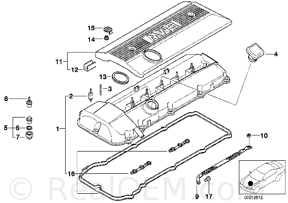

mis sellest arvata? tihendi kood on 11127526447 (nr. 13 pildil), kas võib nii olla nagu ta räägib? http://www.realoem.com/bmw/diagrams/n/u/25.png (copy aadressi ribale)
I don't know if this will help or not but--there is a gasket that sits between the oil fill cap and the valve cover--if there is air seeping past this spot it can allow air into the crankcase and will be sucked on into the throttle body and take oil along with it--check that gasket and check for other vacuum leaks as well.
